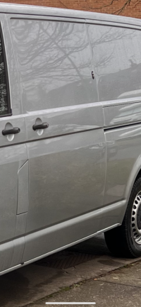

Locks can be removed. Took mine off. Have you got a photo of them?
Ah. Mine was different type of lock and was easy to cover the hole with the side glazing.
Still possible to remove the bolt, I’d say. A locksmith should have no probs with that.
You need to ask yourself how much you like the van. If you want to remove that lock.. it's going to need some bodywork after
I'm not actually too fussed about the cosmetic aspect, perhaps I could paint it darker to blend in a bit. It was more around the usability.

Pulling to the left, either poor tracking/ worn bits related to the suspension which is an easy fix at a knowable garage or been in a shunt and the subframe is bent, unlikely as I’m sure it would be obvious from its history. I had my tracking done at Bognor motors on a hunter alignment system a couple of years ago now and the wear on all the tyres is so even it’s definitely worth it. I’m sure with the locks you could disconnect them from inside the door, I’d leave the locks on the outside as it might put off any chancer looking to screw the van.
After doing some research I believe these are slam locks, and have found this description which fits perfectly:
"Van Slamlocks work by de-activating the van’s factory fitted door handle and installing an additional surface mounted lock to the van door. To open the van door, you have to turn the key which now acts in place of the door handle. On closing the door, locking takes place automatically so ensure that you do not leave your keys inside the van!"
Not sure I like the sound of the de-activating of the factory fitted handle but this definitely didn't budge....wonder if it's going to be a pain to reinstate.
