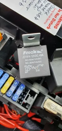

I've bought a cheap "Relay 100" to dismantle, to see how easy it is to convert to a plug
The relay arrived this morning, its the correct fit and as expected. The top pops off easily and all the tags are easily identifiable within the relay, so its a trivial task to either disconnect the coil and leave the mechanism in place, or remove the coil & armature to make a neater job. Inside the case, all the internal contacts have a large exposed metal surface, so soldering suitable cables should be straightforward.
Cheap, instant B2B plug for your Ctek or whatever, no mods to the van wiring and instant reversion to standard if needed

Took the advice and ordered a cheap (~2€) relay from China which has right connectors. Pleasant surprise was that contacts have quite large exposed metal area which willingly accepts soldering. Also the base was well heat resistant as the cables soldered were 6 mm2 (about AWG 9) thus needing proper heat up.
Having it now as a plug instead of two separate spade connectors also eliminates having energized open male connectors when disconnected (Ctek Smartpass 120).

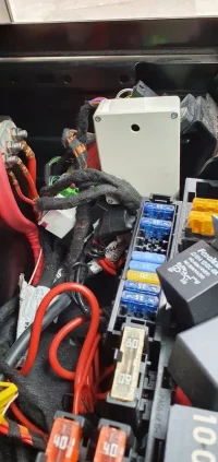

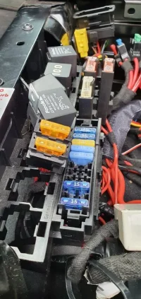

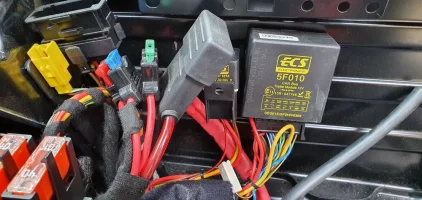

I have aftermarket towbar electrics (ECS 5F010 CAN Bus Trailer Module and an ECS 20 201 101A 12V 20/30A) under the passenger seat. I have an aftermarket inverter (Mercury Soft Start Modified Sine Wave 600W 12V) under the driver's seat, disabled for power saving. The inverter supplies two mains sockets in the rear, these also have two USB sockets each. There is an aftermarket switch on the dash which disables these extra USB sockets (not sure why it doesn't also disable the mains sockets).

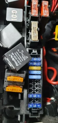

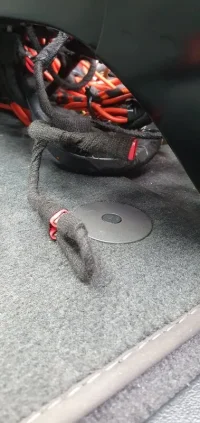

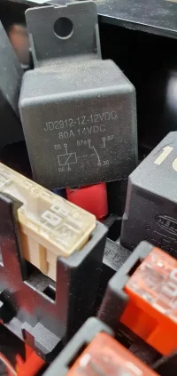

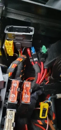

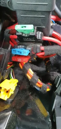

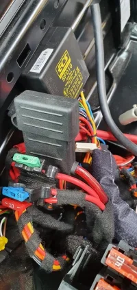

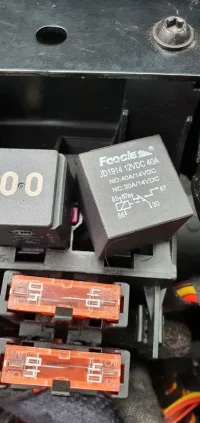

I took a bunch of photos, can anyone help me identify what is going on and/or help me with my CTEK install?
Thanks Loz! Are you able to help me understand how to adapt your guide to my setup? Whilst I am confident I could have followed your guide, much more knowledge than I possess would be required to be able to follow the instructions I received from travelvolts.
My instructions refer to the California split carge realy that is a larger 150A relay used when you have 2 leisure batteries, the connections are bolted on to the terminals and therefore easy to remove and connect to the dc-dc charger.
You have the single battery setup that uses the 100A relay, seen in your photo with 100 on the top. As the connections for this relay are made into the relay base it’s not so convenient to remove them. For this setup @travelvolts supplies a loom kit that simply plugs into the relay base in place of the relay.
