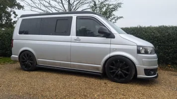

SoLow "Low" coilovers now fitted, along with new strut top mounts, drop links and PU lower rear spring rubbers.
Delighted with the results. The ride is amazing, so smooth, no clunking or knocking and handles like a dream....enjoying driving my van again. Just a laser alignment to get done now, then hopefully, my tyre wear problems will be sorted.
View attachment 261066View attachment 261067
Lovely van., it's amazing how good SoLows are especially when other suspension components are in good condition too.
