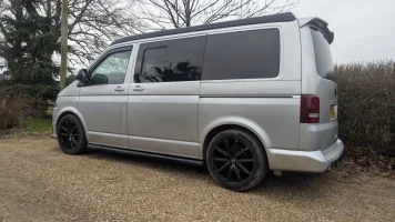

Hi @mattyd247
Van looks great. Do you remember what size wheels and tyre details you were running in this photo??
Also is this them (the NSL’s) on the lowest they go, or do they go lower???

The wheels in that pic were Cades Hera which are 20’s, 9” wide and ET38. The tyres were 245/40 20 Nankangs which were load rated at 103.
The fronts were nearly all the way down so about 90mm drop and the rears were all the way down without removing the adjuster.
Hope that helps.
Hope that helps.
