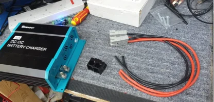

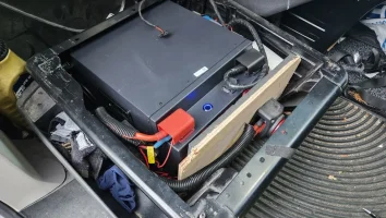

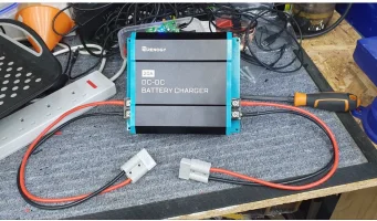

Thought I'd update this. My electrical install is finally complete and I'm very happy with how it all functions.
- Wired Campers 20A DC-DC (Renogy)
- Full Wired Campers 12v 'Kit'
- WIred Campers EHU Kit
- Fogstar Drift 105
All under the drivers seat, EHU hook up under bonnet. Separate switch in the fuse cover to switch the D+ signal if needed.
