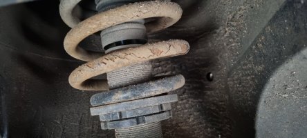

I had a set of H&R coilovers fitted to my t6 in Nov 21.
I checked my wheels today and noticed that the black coating has peeled off the springs and are going rusty. I understand that they face all the weather but should they be this bad after 17 months?
I must admit I don't polish them every Sunday but this is just general use and I don't live by the sea where there is a salt issue.
My original springs weren't this bad after 5 years of being on the van.
Opinions would be great to hear.

I appreciate your reply but I dont expect these to be peeling like an onion after 17 months use. As I said my factory springs were in a lot better shape after 5 years let alone 17 months. I suppose i am asking is this normal?
I was expecting the quality to be better to be honest. I would be interested to see what the condition is of others with the same age and set up.
Surely the purpose of the plastic / painted coating is to prevent rusting and without it will speed up the rusting process (life expectancy). Again these are only 17 months old.
I am not happy with the springs and the rate of corrosion. Do you have the contact details of the manufacturer and any info on the warranty as I don't want to be changing these every two years due to not being fit for purpose.

OEM manage it no problem. Aftermarket generally don’t.

They do look particularly bad. I live in north east Scotland, near the sea, shit rusts up here….. none of my Van coilovers springs look like that and they’ve been on longer.
The threads/damper bodies though, look fairly typical.

Your pictures have been sent to H&R head office in Germany , they have asked for a purchase date from us please . They want proof i guess that these are 17 months old . If you have an invoice number i can work with that .
Invoice date was 30/11/21
Invoice: SI-469
If you need the actual invoice I can message you a copy.
So this wear is not normal then?
Much apreciated
++Update++
I received repacement springs from H&R under warranty. Interestingly the replacements are red where my original ones were black and the coating seems much better in quality.
I wonder if the black springs were known to have premature rust issues??
Anyone with the black springs fitted on their H&R coilovers you might want to check on how well they are holding up.
