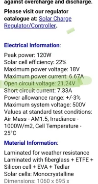

just use whatever solar panel you want . . . and get a seperate solar MPPT controller.
or.
stick using the CTEK solar input, but get 2x smaller panels (below 23v voc and run them in parrallel. .)
eg 2x 100w in parallel @ 18v voc

Worth a look through all their panels, some are 23.9V, others are below 23V and higher wattage. I particularly like the ones with the round rear cable entry as it makes installation very simple vs those with a larger squarish cable entry.
