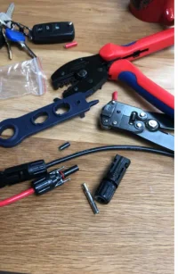

Not very obvious but this is me making the fly leads and extension leads (yes the wife was out hence using the kitchen top :whistle::whistle:)
bought some new tools - the MC4 crimp tools - worth having but if anyone in oxford area wants to borrow them give me a shout.. its not the kind of thing i use every day.

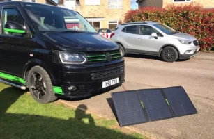

At about 5pm this evening i plugged it all together. I'm highly delighted with it all:
As above.. 3 pannels in sunlight
37W shown - the highest i got was 48W and that put about 3.6Amps current output.
