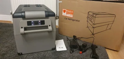

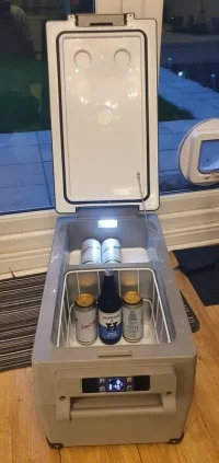

I've spent wayyy too long trawling through trying to find what fridge to buy. I ended up getting the cheapest 30ish litre I could find which was the Vevor 35L, it seems the same as the Aplicool CF35 and very similar too the Polarbox 32L. It was only £220 delivered from the Vevor website.
Vevor 35L
The fridge turned up today and I'm super pleased with it. The quality is better than I expected. It chilled down (empty) to -2 in about 20 minutes. It can be controlled remotely via the Alpicool car fridge app, this also allows you to change the battery protection settings etc.20210602_212748.jpg20210602_212501.jpgScreenshot_20210602-184834_CAR FRIDGE FREEZER.jpg
My only gripe was the Hermes driver denting the van delivering it , Prehaps thats karma for buying a cheap chinese copy?
