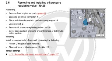

Well, the implausible signal might actually indicate faulty oil pressure regulating valve.... Quoting my own analysis/speculation:
Analysis of fault codes - to be continued...
Background
  • The fault codes do not identify low/high-pressure sensor.
  • Working hypothesis is that implausible signal (P164A) possibly points to regulating valve - the switches have only states open/closed. Thus implausible would possibly mean oil pressure switch not responding to commands of oil pressure regulating valve... (see switch (oil pressure) responses to oil pressure regulating valve in the graphs above, especially the full throtte case). TBC...

Same happened to my van, I changed the oil pressure regulator and that solved the problem. All been ok since then.

I’ve changed all the oil pressure sensors, regulator 3 in total and it’s still flashing,
Oil pressure is good.
could it be the pump @ 44k
Don’t know where to look next
