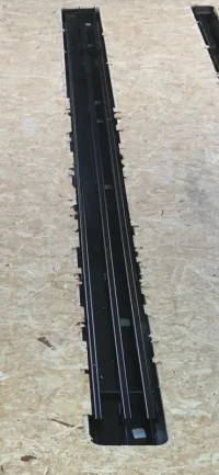

View attachment 9942 View attachment 9943 View attachment 9944 View attachment 9945 View attachment 9946 View attachment 9947 View attachment 9948 View attachment 9949 So I finally got round to finishing the floor after I had lined the van out, using the original caravelle floor that came with the rails I made cardboard templates both sides of the wheel arches then made thin ply templates and screwed to the top of the floor, took the floor back out then cut the four sections out made up some new pieces with 9mm ply fitted to the floor and put back in retrimmed with new carpet thanks to @slidepods for giving me suppliers details for this job done!
Thinjking about this now, how easy/ difficult is it to get the carpet off the OEM floor. Im worried it might pull lumps of the chipboard away.
The carpet on mine came off fairly easy however around the edges of the rails the board is machined down very thin and it did break off but it didnt seem to have any detrimental effect on the new carpet I think it just acts as a stiffener to hold the carpet up and prevent it sagging down maybe an issue with thin carpet
