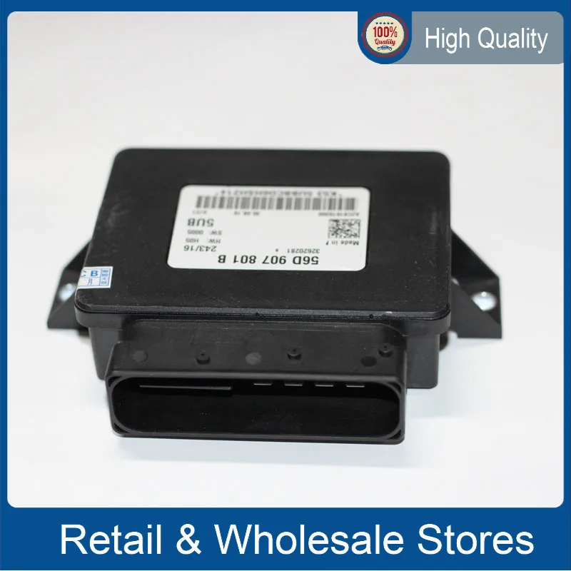

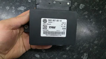

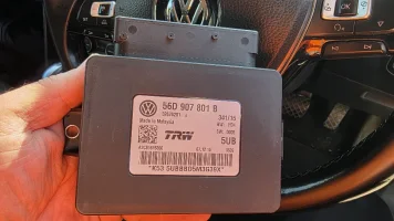

I have read though all of this thread and am wanting to do this conversation on my T5.1. I can source all the comments apart from the 56d907801 control unit. Can anyone advise or know anywhere I can get one from?

no, even after dump read - no differente, just indexDoes anyone know if there are significant differences between 56D 907 801 A and 56D 907 801 B?
