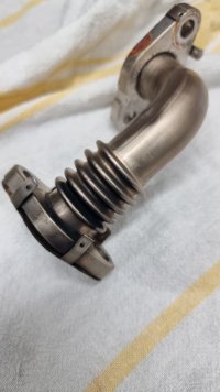

Exhaust Manifold To egr inlet pipe, I bought one of these from Vw parts centre in Liverpool on Friday, and it was surprisingly cheap at just £27!
The bloke on the desk said they sell lots of these, it’s a common failure, hence having the part, the gaskets and new bolts in stock on the shelf.
He also said that this parts is cheap, but they do have an updated version with a solid elbow on it which is £105.
I was really surprised by the price at £27, it was £85 on most places on line….
Did it come with the shim/gaskets or did/were you able to reuse the existing ones?
The gaskets look Like single use with a crush ring .
The other similar pipe coming out the other side of the egr has same gasket at one end, but a rubber seal At the other where it goes into the inlet manifold.
I got new gaskets and new bolts as the ones that came out the exhaust manifold looked an
Little stretched and it was a worry taking them
Out with a lot of back and forth on the ratchet.
It was re-designed to prevent cracking, IMO you should have bought the latest version if you are keeping the van.

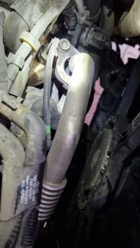

Just spent an hour or so replacing the front EGR pipe after that decided to break last weekend.
The pipe had come apart from the "bracket" at the EGR end, which resulted in a flashing coil light, and (eventually) EML.
As others have said, the last bolt is a git, as it's virtually impossible to see.
Interestingly, the failed pipe was one of the revised part number, 04L131521AR, rather than the original, 04L131521AG.
Anybody else seen failures on the supposed improved design?

Had to buy another for mine. Haven't done it yet this time. Its the revised one15 months old it has a hole at the inlet manifold end. Where the brass weld is there's a pin p***k hole blowing. I noticed from smell so checked and it is all black around it. Took it into work and smoke tested it. Sure enough a small jet of white smoke from the tiny hole.
