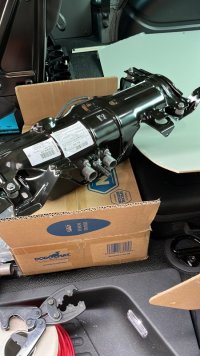

Hi, where did you get that fitting kit please. When using that does the heater line up perfectly with the OEM B pillar parts?Eberspacher VW Mounting Kit arrived so dry fit to make sure it’s all there
@Skyliner33 Hi, I ordered from TPS. and no the D2L doesn’t quite line up with the footstep and B Post ducting. Apparently the D4 does, but the D2 doesn’tHi, where did you get that fitting kit please. When using that does the heater line up perfectly with the OEM B pillar parts?
