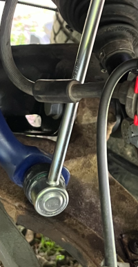

I’ve had Lemförders for 1.5 years now without issues. However my van is not lowered.
The OEM drop links are actually U-shaped profile
I did some research back at the time and concluded Lemförder is top aftermarket quality, and they are OEM provider for BMW. Their drop links felt more substantial in hand than OEM ones and look better made.
Take what you will from above, just another 2c
Forgot to say mines lowered 70mm on H&R C\O & H&R ARB with the Lemforder ones & been on a year without issues.
The OEM ones I had on I’d got knocking on one side after 2years & they look flimsy compared to the Lemforder ones so hoping they last longer.
