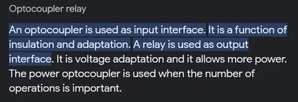

Sounds like he's making the job far too difficult. An optocoupler relay connected to the courtesy light circuit that switches a clean 12v for the bonnet light is all that's required. This will negate the issue of the PWM dimming and the fact that the courtesy circuit is switched on the -ve side.

I had to Google "What is an optocoupler relay" and I still don't really know or understand...
