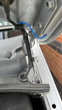

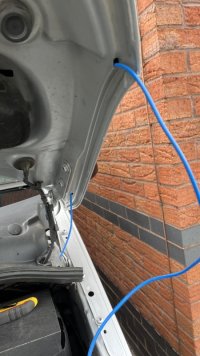

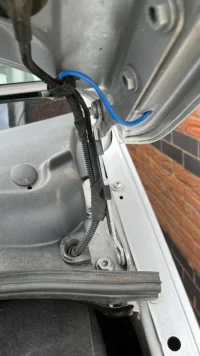

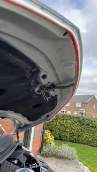

Any chance (pretty please) of photos re wiring routes & terminations?
I used the same wiring connections as @VioletVW showed in post #59, so a tap on the fuse box in front of the battery, and a ring terminal under that body bolt. The wiring is cable tied around the bonnet hinge as shown in photos below:
