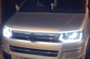

I’ve brought some dynamic led lights that go under the bonnet. Like in the picture. I’m guessing that I wire the live to the DRL wire and the other to earth/negative. Does anyone know which number pin is for the DRLs that I should tap into?

Got a piggyback fuse and plugged into first fuse top right hand side in fuse box under bonnet. 5 amp fuse fuel pump supply so comes on with ignition and stays on 30 seconds after ignition turned off. Black wire to ant ground but I put it to neg terminal on battery.

My first one only lasted a week or two however it was very loosely fitted and wired badly which I think was part of it. New one been on for ages and ages now. More than a year I think.
Mine has lost a short length of elimination at one end ATM. Nothing to fret over

I got mine from Very as per some of the original links and they are I think 2m. They cut down fine but dont need to be. Make sure to seal up the square rubber end as it is only on loose.

I’ve bought one of the hood lights. First problem was it wasn’t sticky enough - easily sorted.
Mine has the amber indicators on. I’ve managed to sort the welcome light but I can get the indicator function to work properly. It comes on but stays on or even stays on if oppo indicator operated.
Has anyone successfully fitted to a T6.1? Where did you fit the indicator wires? Pics etc greatly appreciated.
