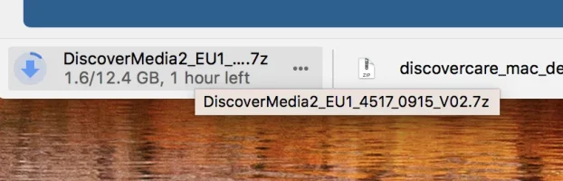

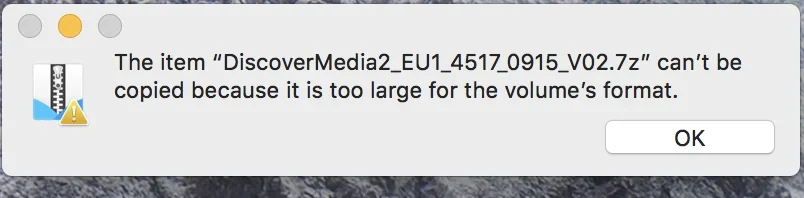

Hi NW, update:downloaded first time and trying to put file into VW sd card it got lost somewhere :( downloaded again, went out for a run and fresh air as ready to explode :) still cant get file to go onto sd card, both times when I opened the file withUnarchiver it didn't give an option as to where you wanted to put, I have ticked all the boxes as explained above, anyway couple of screenshots of message when trying to put file into sd card - happy days :)
