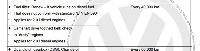

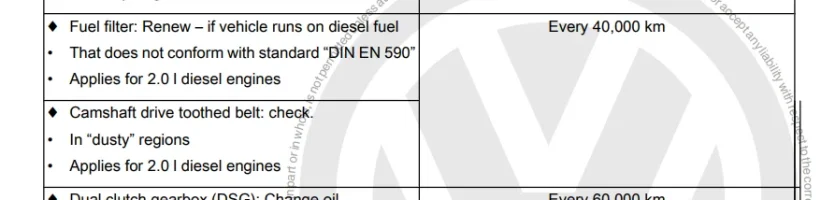

I'm confused! o_O On other threads on this forum, it has been quoted as 4 years or 120,000 miles. The 'Service_scedule_additional.pdf' hosted on this forum quotes (ignoring the lower "Dusty" regions figure) a distance of 210,000 km which equates to 130,000 miles.
Am I missing something? Which is right? ;)
I don't disagree this is a standard figure but the official VW figure is 210,000 km and we should also be consistent with advice on this forum......
the 2016 vw transporter maint book as @Loz pointed out states:
200k would be 124k miles ish.

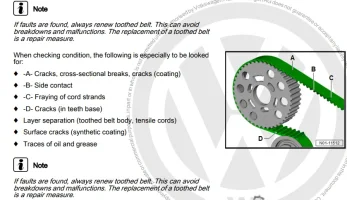

this book dated 09: 2018:
states:
and
so its listed as regular checks . . . . .
and to replace on or before 120k miles . . . .
but no year/age listed....
yet other sources state 4 years . . . . .
so lets say it needs checking regular at service intervals
it needs changing at 120k miles or 4years what ever is first . . .
the waterpump is always listed as an option to be replaced at the same time.
so 85k may be a bit soon - but remeber its an interfereabce engine, so if it lets go its gonna do damage
