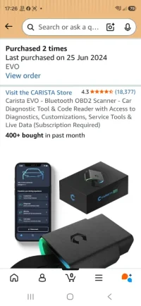

Looking at that data the fuel pressure should be at 200bar when it’s not running, is that right? I just checked mine and it’s between 155 and 165 on Carista (can only get live data, can’t log it) it’s been sat about 6 hours.
