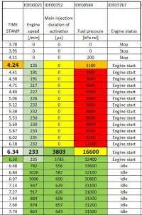

Ever since I bought my T6 18 months ago, on a "cold" start (in the morning or after work), it'll take a few seconds to start up. The crank speed is high and healthy and the situation is the same regardless of the amount of fuel in the tank.
The battery has just been replaced and coded just in case.
I've also replaced the lift pump with a Bosch part from Parts In Motion (same as genuine, stickers and markings match up to the VWAG one I took out).
Changing these 2 parts made no difference.
I've done a lot of reading on here and I'm not sure whether it's timing or fuel delivery related. I have genuine VCDS and have followed the guides for obtaining data for engine off, cold crank and engine running. I have attached these below.
If anyone is able to decipher the data and help me out, I'd really appreciate it.
Thanks!
