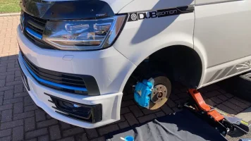

All done on the rear's with the barrels of the Davenport's cleaned up as well. I've run out of what to do on the van next. Thanks @Loz for the cable as well. I've PM'd you. :thumbsup:

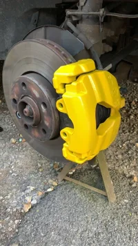

Thought I’d add my 2 cents for anyone considering the DIY route.
Combi drill with wire wheel attachment
Wire brush
Break cleaner
Motip spray paint (4 coats)
Patience
Heat gun
it’s been 6 months and they still look the same once cleaned up!
