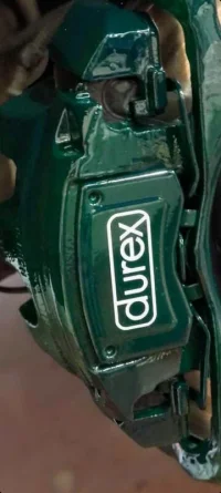

Hmmm, this is taking a bit longer than I imagined, it's a complicated shape. I have one I think is now acceptable.

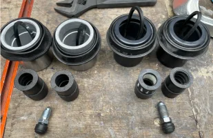

A bit dismayed this morning.
Before starting the second caliper, I thought I'd strip out the components of the calipers and vac bag them to keep them rust-free ect. but was a bit dismayed between the quality of the components of the second one, it almost looks like a copy part.
The second one is on the left, it doesn't have the nicely engineered blue pistions, it has a cheap cover seal with a bit of wire in the seal to keep it seated but they also glued it in place, whereas the the one on the right has better quality seals that just stay put as the grip onto the casting properly. One of the guides on the right had a moulded in nylon guide where as neither of the send one does and even the bleed nipple is a cheaper one!
