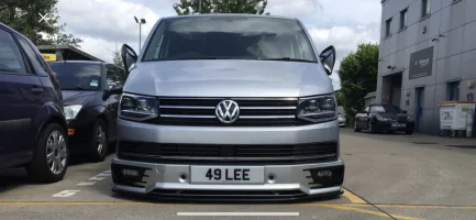

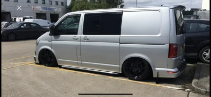

Yeah seen you on here a few times
Yes pretty similar vans, yeah it’s a genuine sportline kombi (3rd sportline I’ve owned love it but need to stop spending money on it)
The e-tech is not really glossy, you do get a clear lacquer, the stickers are brembo stickers I put those on just to smarten them up really, they are standard sportline calipers
I got the sportline stickers off eBay as I liked them on my old T5.1 sportline and thought they looked plain on standard T6 sportline
I’ve just had air ride fitted which makes it extremely low when you want, normal ride height is set just on controls so easy to change
Also just fitted a front lower splitter which I think finishes off the front spoiler
I went to players show on Sunday and now want different wheels lol, where does it stop, already got Bentley wheels as 2nd set but decided to sell those now
Cheers
Lee
Cheers
Lee

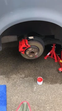

I used the E-tech red calipers paint and painted in situ. Just took the springs off, wire brushed them, wet n dry’d then, washed and then cleaned with brake cleaner. I used a few different sized paint brushes and a very steady hand to paint them. Took a bloody long time but I wanted to make sure they were tidy. A lot of effort (especially without a ramp or decent jack) but was well worth the effort I think....
