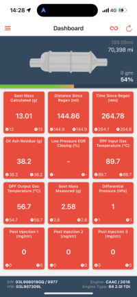

Hi Tom, I have a CXHA engine and I'm using group 3, is that correct? I had an odd value for miles since regen, but I think the time since regen looks OK and the other values seem to be of the right order. Having updated the app today the miles since regen is still strange. Screenshots attached, updated version is first. Both taken today. I don't have hyperdrive fitted, honest! Given the miles travelled in the top section the numbers look as though they are OK, but with the decimal point in the wrong place.
View attachment 219089View attachment 219090.
Am I doing something wrong?
Hi, you're not doing anything wrong, this is indeed a bug. It's being fixed as we speak - let's see how quick Apple are to review it :-)

Thanks again, very useful app, except it is disconcerting watching the bar climb from just over 20% to 70% in about 80 miles mostly 50 to 70 mph - suggests maybe just over 100 miles between regens :-(
About the same as mine on the motorway and urban is more like 60 on a 2017 @ 70k. What's yours?
Nope, just my updates coming through slowly, It is there now and dowloaded, but I'm not in my van today so can't check it.
What's your oil ash percentage? Hit oil ash residue and it'll change to a percentage.
Think it was about 53%, not much different to the grams figure. Not expecting that to be linear though, so in reality likely to be well over half way through its mileage lifespan :-(

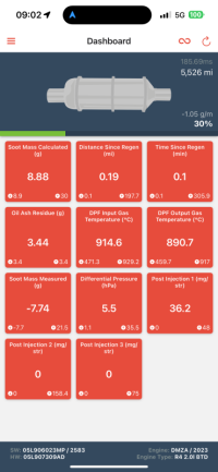

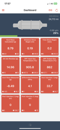

Here is a series of screenshots I took today in the lead up and during a regen to help explain my queries:
Just moments before the regen:
What do the "post injection" 1-3 boxes mean and why do I only have a figure in "post injection 1"?
With the regen underway all 3 "Post injection"fields are populated. Why only during a regen so these boxes populate and why are they so wildly different to each other?
2 miles down the road after regen started and all looks normal? Why does the soot mass measured fall so much faster than the soot mass calculated? What's the difference?
Five miles into the regen and the soot mass measured is negative.... how and why?
On completion of regen I am left with a calculated soot mass of just under 9mg. Is that normal? Why isn't it nearly zero? Why is the soot mass measured a negative figure of -8.49mg?
Post Injection is how the ECU raises exhaust gas temperatures to burn off soot. See page 60 of https://pics.tdiclub.com/data/517/820433_EA288.pdf.
It is normal for the values to only be populated during a regeneration. The ECU decides how much fuel to inject and when. The three values correspond to the post-injections referred to in the Self Study Programme I've attached above.
The ECU provides two mechanisms for measuring soot mass. The main value used by the application is Soot Mass Calculated. This is what the progress bar uses.
I don't have all of the information to fully explain the difference between the values (they're both available, and I display them accordingly). What I do know is that Soot Mass Measured does not take into account the Differential Pressure sensor. This means that when the Differential Pressure sensor fails, Soot Mass Measured is now the only true source of soot mass. As soot mass reaches field thresholds (the point at which your vehicle will attempt a regeneration), both values (calculated/measured) will become close to one another. It's unknown as to why the VAG engineers have negative values in the early stages of soot filling.
Your primary focus should be on Soot Mass Calculated.
This is normal. It is impossible to burn off all soot. As the condition of the DPF worsens and oil ash content increases, the end of the regeneration procedure will be at higher levels of soot. Unfortunately, this does mean that regenerations become more frequent as the vehicle ages.
Additionally, as the amount of soot decreases, more fuel is required to be injected to continue burning. The ECU is programmed to stop the regeneration process at a suitable time that balances efficiency. Yes, the next regeneration will occur sooner, but that is countered by using less fuel at the end of the cycle.
