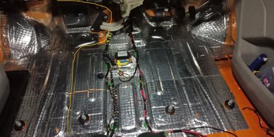

i actually ran it underneath the van using these two grommets, encasing the cables in conduit. This allows future cables to be ran between the two without needing the remove bases and lift the floor, as well as removing the worry that constant footfall will cause any wiring damage.
That being said, there are cables running underneath the rubber floor that seem to hold up well (I recently had some floor up for another reason and the cable was fine) so I just went over cautious.
But yes, nothing ran up through the bulkhead with mine.

Is there a splash shield or diesel tank in the way underneath? Or can you readily access them both from underneath?
Never thoughts about using those two grommets @Ads_Essex :thumbsup:
Heat shield mate. There’s room to manoeuvre though.
Nearside possibly has the AdBlue tank if you’re Eu6 and a heater on the offside if you’ve got a factory fit jobbie -

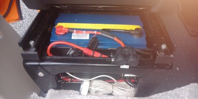

I went under the passenger seat. Wanted the space under the drivers seat for air out let for heater. I did mount the DC-DC under there though. Dead easy cable run through the bulkhead grommet
I fitted my battery, DC-DC charger and fuse box under the passenger seat, used the existing channels to route the feed from the starter battery through the grommet in the bulkhead under the scuttle and down following the channel marked, covered it with an aluminium plate to protect it once in place. I did keep the battery upright though, which meant having to raise the seats to ensure nothing touched with the captain seat rotation.

I had an Enduroline AGM battery (354 x 175 x 190) under the passenger seat with a DC to DC charger mounted in front of it. All good until I decided to fit a swivel base as most use the recess in the seat base for the swivel mechanism. I tried a couple before finding a CTA one that just cleared the battery underneath.
I've got a 230Ah LiFePO battery now and even the CTA swivel wouldn't clear that so it's under the driver's seat and a ton of rewiring had to be done to move it.
