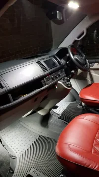

I've started fitting these but I didn't find it easy. The instructions are okay but I'm not necessarily the most adept at this kind of thing. I read the instructions and then all 9 pages of this thread and you'll need a couple more pointers by searching on Google (even if it leads back to the forum).
Here's some help if you're like me: How to remove the cab interior lights and, if you have a Startline or Trendline model, how to remove the storage box above the interior lights, as this kit means you have to. And then you need to modify the cubby hole box to fit it back in. I've yet to start thinking about how to cut the hard plastic shell and get it back in (to stop my famly losing things through the hole of the box or poking their fingers into the electrics).

The result in a Trendline (and presumably Startline) before running the yellow wire down.
@saxoboy it might be worth changing your original post/the thread title to make it clear that this is for Highline spec vans only without the cubby hole storage (and not Caravelle, I think I spotted too)? and it's not a simple mod for the Startline and Trendline specs. Also, it's not plug and play given that you need to solder the dimmer wire in, or use a snap-in block (which I need to get some more of, as I'm out of them), so that is a little misleading. I'm okay with the outcome. I'll find a way to modify the storage box, but I would have preferred to have known up-front about that limitation rather than read it several pages into the thread (and I don't think it mentioned Trendline explicitly, so I wasn't 100% sure that I would face the same problem as a Startline owner).
I'm looking forward to the second part of the install, and I'll post another guide to help others with the roof lining, a-pillar and wiring.
Oh, one question - I popped out my headlight switch and there are two grey/blue wires, one has black dots on it. I presume it's the plain grey wire with blue stripe without the dots that I splice into?

Well, I've found a solution for Startline or Trendline owners...you can adapt the unit to fold the connector back over the unit. It's an pita to do, but better solution than cutting the storage box:
Here's the problem, there's no space behind the light unit.
First cut through the plastic mount for the connector.
Fold the connector over itself (about an hour of fettling) and then you have to cut the hook off the storage box as it clashes.
and finally fold it even further to get the light unit back in.
and at the end of a couple of hours I have lights back in, but I still haven't run the wire down for the ambient lighting.
it's not what I anticipated I'd have to do when I bought this. If the rain ever stops I might work on running the cable and then I might feel better
Well, another hour and a half of fitting and the ambient lighting isn't working. I fitted the footwell lighting at the same time (which had it's own problems as the cutouts are too small for the lights, but I managed to sort that okay) and thought I would run the ambient lighting down the passenger side but I couldn't find a grey / blue line on that side to tap into, so reverted to the drivers side.
It took a while to find the right route down the a-pillar to the light switch and then I found two grey / blue wires, one plain and one with black dots. I umm'd and ah'd about it, checked the colour of every other wire; blue/yellow - grey/white etc, downloaded the wiring diagrams but couldn't find a grey / blue line on the lighting switch on there, and hadn't had a reply from @saxoboy earlier in this thread, so eventually I did this:

Hi Andy the correct blue/ grey wire is in pin 10 (should be the thicker wire). You should find this on the plug that plugs into the switch...Matt
Thanks Matt, I'll try that. Not sure if it's my Trendline that has a different loom to the Highlines, but it has a grey /blue (not discernibly blue / grey, by the way) and a grey / blue dashed or dotted as well. Pin 10 will be the dashed / dotted line. Here's a better picture:

Hi @Andysmee ...this is how mine is connected...hopefully you get it working tonight and its the grey/ blue wire to the right of the switch that you need to connect into. ......Matt
That's working now, thanks. It would be good if you changed your instructions to say pin 10, for the avoidance of doubt.
