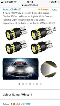

I used these, bit cheaper and guaranteed not to flicker
These are on the photo earlier in this thread
