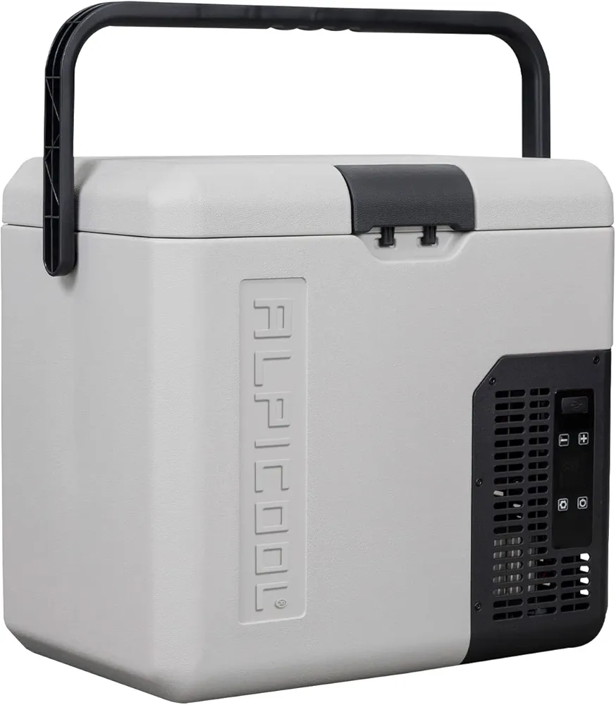

While the discount is on I'm considering an Alpicool fridge. I had wanted the T36 dual zone so I could freeze but the space with all seats in the Caravelle is not enough so I'm looking at the P18 which looks to be the dimensions of our existing long serving CampingGaz thermoelectric one that fits fine.
I note that many of the Alpicool units has the ability to take a 175wh battery, but finding them seems hard and they seem to be as much as the fridges. I like the idea and convenience but at £1 a wh seems poor value compared to investing in a proper second battery system.
If I'm not going to use the battery the bay does seem to take up a lot of space in what is already quite a compact unit.
So:
1. If you have the P18 how do you find it?
2. If you have an Alpicool battery how well do they work and would you advise finding one?
3. If you have a battery capable Alpicool can you use the bay for anything else like cable or adapter storage (I assume it comes with some sort of lid?)
4. If you own an Alpicool is the cable socket likely to be on the end of the side of this one - none of the images anywhere seem to show it!

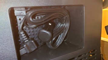

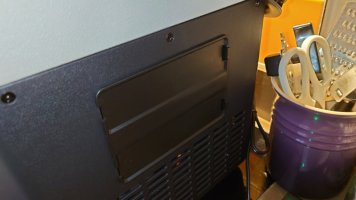

The battery bay does come with an outside cover that clips on. Sadly the mains adapter is fractionally too large to store there but it does take the 12v lead just. The instructions say it comes with a cover for the battery terminals, but it doesn't and I suspect those are live so keep that in mind if using the bays.
The power connector is on the back of the compressor section, which might be annoying it you need to slot it between things. However this is also where the small fan to mainly vent the heat is so you'd need to take care of that anyway.
I find it baffling in tons of pictures and video in the adverts and on vendor sites I could not find one view of this side!
There is also a DC jack rated at 12v-50v which the manual makes no mention of at all beyond "solar input" - I guess it's up to me to figure out jack size and polarity. Seems little use without the built in battery.

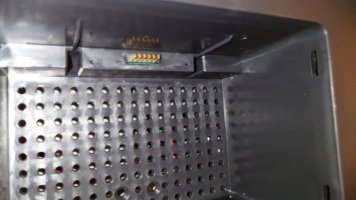

Long term I am pondering about removing the battery bay and solar feed wiring and using the space to hold a mains PSU.

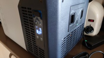

So it's arrived and on test.
Things to note in early testing:
  • When in the fridge it will power up and charge, there is no option to have it in the fridge and "off"
  • The display changes from the incoming power voltage to the internal battery voltage, and the battery level meter animates to show charging
  • Apparently charging is slow if the fridge is running, which seems to be the case so far. Operationally that might be annoying but I guess we will have the box in the motel on power over night so :whistle:
  • Annoyingly the same voltage protection levels seem to be applied to the internal battery as incoming power. That's a pain in our use case of just wanting it to run the fridge while parked on day's out, either we leave it on high (to protect vehicle battery) and it doesn't use as much of the internal battery as it could, or we change it to low but forget and it drains the vehicle battery...
Features of the battery itself.
  • Brief press of the switch will show the battery gauge
  • Long press turns off and on when the fridge is running off internal power only
  • It does have a 3amp charge socket. Not sure where I would get a lithium charger with that and with only one battery I can't see many times charging out of the fridge would be useful, but nice to have the future option

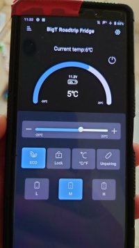

So a surprise discovery from noting the display had a very tiny Bluetooth symbol is that this fridge works with the Alpicool app and it's actually not bad at all.
Certainly it makes switching modes much simpler than remembering all the button combinations and would make switching voltage cutoff profile when leaving the van and let it run on the internal battery much easier.
Also allows access to a fewer deeper config items like the temperature corrections that may prove useful.

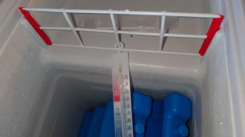

So on the test I have 2 2litre milk bottles in the fridge, a carton of juice and one of my normal thermometers (they were handy from the weekly shopping!)
The documented battery charge time from empty is 8 hours and that seems about right.
The fridge has been running on internal battery now since midnight in our house using the ECO setting and has used about 40% of the capacity with the target temperature of 5 - which it's holding fine.
One thing to note is that about 10 hours in the fridge went into the F1 fault state due to battery voltage, but this was set on the HIGH protection setting.
There is no direct indication on the display that the internal battery is in use, however the lower voltages are a reasonable clue.
On the battery there is a large indicator that is bright blue when the battery is ON but which is bright green when that battery is under charge, so that's a good indicator. Also there is a small set of 4 blue charge level indicators, these animate when charging with the non animated ones showing how charged the battery is. Interestingly the battery has 4 levels of indication (25-50-75-100) the control board 5 (20-40-60-80-100) so they don't always agree!
So end of the test at about 9am this morning. The fridge had gone into the F1 low voltage state again on the M protection setting and the battery was showing 40% on the fridge panel but 25% on the battery itself at about 7am. I put it into the L protection setting but somewhere between 7 and 9 the battery shut down before the fridge did and it was completely off. Internal temperature was still 6 though.
So I'm grudgingly impressed with the runtime, having got a reasonable thermal mass in there the battery gave about 30 hours of cooling on ECO with a 5 degree target in 20 degree ambient. Admittedly I didn't open the lid much but I was cross checking the indicated temp with the independent fridge thermometer I had inside.
Other things I did having discovered it works with the app is to set a few of the advanced parameters:
  • Start Delay - was 0min now 3min - thinking here is if the compartment warms slightly with the lid open to get stuff in and out this gives a couple of minutes to stabilise rather than kicking in straight away
  • TC Shutdown - was 0 now -1 - the compressor will kick in 2 degrees over target (Left Hysteresis) but will now hold until 1 degree under target. I'd rather have a bit of longer compressor run as it's the start up surge that tends to kick in the voltage protection. Camping I tend to target 5 degrees as a trade off between ultimate food life and energy - for this fridge it needs to keep stuff a day or so not all week.

So I've been running it with a couple of big ice packs, bottle of water and the fridge thermometer up and down the freezing range to work the compressor.
Also top tip - if you think the compressor is suddenly really really rough check your dividers! I added a little folded over PVC tape either end to cure that.
As I'm doing that I've been moving the target from -3 to -9 to -16 to target the correction ranges.
Currently I have the following advanced settings in the app and it's behaving well and mostly agreeing with my other reference thermometer:
