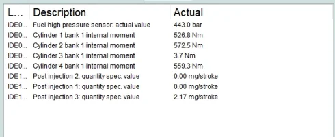

After choosing variables to monitor in vcds I get Cylinder 3 bank 1 internal moment at 3,7Nm while the others are 526-559NM.
I also get Post injection 3 quantity spec value to be 2-3mg/stroke while the other two, 1 and 2 are 0.00mg/stroke (I have tried figuring out why I only get three values on a 4 cylinder engine, but concluded that the 4th is the one the other 3 compares to.)
