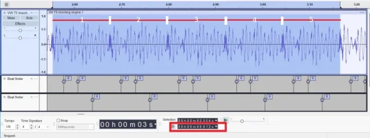

I see the recording (video in post #1) slightly differently, snippet below. Highlighted section of 612 ms which contains 5 engine combustion cycles. To fire all the cylinders it takes two crankshaft revolutions.
Thus 612/5 ms = 122.4 ms which equals to 8,2 knocks/second which then equals to engine's 980 RPM.
Well, there seems to be two consecutive knocks 30 ms apart and then 90 ms "pause". See first Beat finder row. I believe this explains your 15 taps/s observation.
The second Beat finder (different thresholding) detects only the "master" knock.
