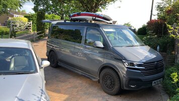

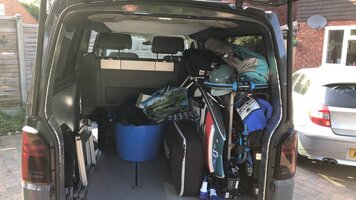

One month on most of the remaining work done and first trip away completed! We just got back from a nice few days in Cornwall seeing my family, doing some kayak fishing off Mullion and of course lots of windsurfing. Am pleased to report that everything worked, everyone was warm and comfortable at night and we were able to cart a huge amount of gear with us. Kit list was:
180litre intermediate windsurfing board on top
130litre freeride board on top
130litre windfoiling / wing surfing board inside
5 sails, 4 masts, 4 booms, various other bits
Two sets of hydrofoils
One massive inflatable wing
Wetsuits, buoyancy aids and harnesses
Less important stuff:
Clothes
Sleeping bags
Camping chairs
Self inflating mattress
Food
Plus four people and one large Labrador.
Some random pics of the van plus finished storage, inverter install with remote on/off switch. All sockets in and working, managed to cut the recessed bit off the panels at the rear of the seat base and replace with some foamex to fit the space before fitting the sockets. Time will tell how robust this is but it’s pretty solid.
Need to finish the ventilation setup for the windsurfing storage and install some rear speakers and a sub under the passenger seat. Would like it to all run off the leisure battery so some wiring to do there.
