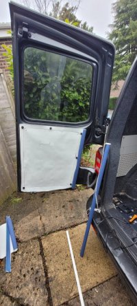

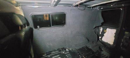

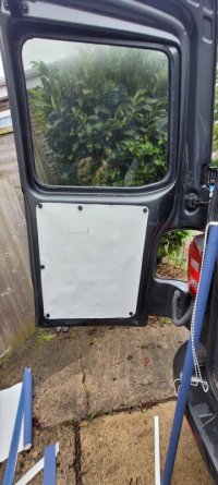

Another incomplete task update, carpet lining offside rear. Started raining so decided to leave the threshold til tomorrow

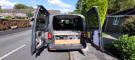

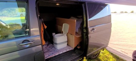

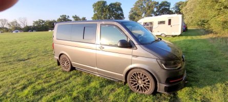

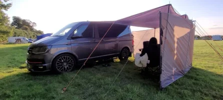

We camped!
van is in a very basic state, a very rush job to say the least but a job done for now all the same. Went to Newby Hall firework champions for the night. Was a great show as ever. Lookin forward to next year. Off to Scarborough thos comin weekend for a hopefully improved night in the van.
