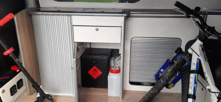

CFCAE941-5E67-48AD-AD80-E67C96C7C5EA.jpegThe fitter put ours here, just behind the rear wheel arch. He put a vent directly below it so there won’t be anything blocking it underneath the van.

Yes I thought about that and eventually ended up locating gas locker under the sink. It's a tight squeeze with the 12 litre freshwater tank bit it actually fits perfect in this position. Should point out that I use a portable fridge so that's why this space is free..
