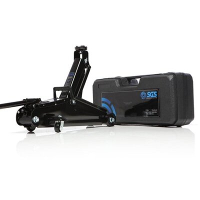

I have an SGS low profile trolley jack that I keep under the rear bench. The bottle Jack's don't go high enough. It's a bit of extra weight but it fits perfectly and gives peace of mind!
It was the price vs practically that put me off. I've got much more trust in a trolley
