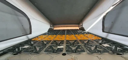

What are those black and orange things?

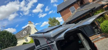

Fitted 2 x 150W panels to my roof and switched the cheap PWM to an MPPT.
The two panels are Firefly Energy 150W black panels from Amazon, £81 each, 104 x 75cm. I took one of on my recent holiday tour round Northern Europe to test it, and it seemed OK.
Fitted them to the T-tracks on my Reimo poptop, total weight 17kg, height increase of 6cm total. It was the easier way to put a removable panel on into the existing T-tracks. Perfect for for the width of the Reimo between the two raised profiles of the poptop roof.
Also added a couple of Craigsolar solar panel brackets at front and back with VHB tape and a rubber sealant between them and the roof, perfect fit, just for airflow and to hide cables. The whole solution is pretty solid on there but easily removable. Decided not to drill the roof at this stage but have organised it so the panels can be connected to the MPPT via a 12AWG XT60 cable through the tailgate without the need for holes.
Total cost, including the £60 Renogy MPPT and extra cables, was under £300. This feeds into the back of my Clayton LPS1 and seems to do a pretty good job of charging but will test tomorrow in earnest.
Also managed to sell my 200W Dokio portable panel on FB marketplace for £135 (£20 profit!) today so overall pretty pleased with it all so far. 😀😀🤣
Great job @d8smt . No flexi panel anxiety, love a rigid eh?! Same brackets on my panel, but I did bolt them through. Good result on that Dokio too.
Those black/orange things are Froli bed springs. See my earliest post last year on them. I've just got a 2.5mm IKEA foam mattress topper (£25) on top and it's really comfortable and doesn't give you a bad back👍

OK, quick testing update on these 150W solar panels I posted yesterday in case anyone is interested.
In 25 degrees sun today, 2 panels (2x150W) managed to pull a max of 277W into the battery atop the Reimo roof when it was raised (about 20 degrees angle). This translated into just over 20.3A into the Clayton through the Renogy 40A MPPT. Tempetaure outside was 26C, sunny but partial cloud.
So a couple of takeaways from this:
1. The Reimo poptop easily supports 2 panels, about 18kg weight including connectors.
2. Although the Clayton LPS2 shows a restriction of 15A in the solar input specification, my Clayton Mk1 took the whole 20.2A into the battery from the panel/MPPT. I didn't manage to get a pic of this but got one showing 18A+ input, so easily above the 15A.
Even partially shaded the two panels were pulling 8-10A.
Overall quite pleased with these for the price (£80 each), happy to share details of anyone needs.
