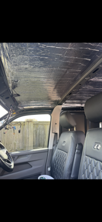

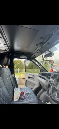

stripped the headliner to sound deaden and thermoline the cab roof. Deadened the door skin as best as I could, and also chucked some on the plastic door card, not sure if this is the thing to do but seen a few things about it online. Definitely enhances the speakers that’s for sure. Then carried on with the deadening in the rear.
Oh and all back together again.. the joys of using the van whilst converting
Did it make much difference (acoustic foam)?
yes, reduced road noise, door cards feel more solid and no rattles at all from the doors.
Hard to say on the audio side as I upgraded the speakers. I did however drive around with no door cards on for a week until I got round to finishing them and they definately reduce the noise putting them back on

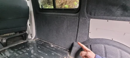

Carpeted the original panels that aren't wrecked and installed. Two rears and the slider to sort later this week. No idea (still) how I'm gonna do the rear quarters full height... meh
