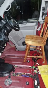

It's when your driving position ends up looking like this that you need to start getting concerned....
(please note: this was for entertainment value only)
