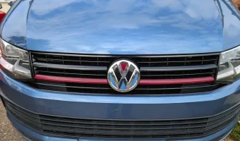

Finally got round to adding the home painted gloss black grille and wrapped trims which match the side stripes and pop top. Had a bit of a shock when I found a false widow nest behind the bumper! Just need the boss to approve the look and can then do the lower grilles
how did you paint it?
Gave it to a mate who paints C-130s for a living so I can't take any credit or blame for it! It's an OEM grille that I bought off the forum as I'd heard some 3rd party ones don't fit well and I don't have £300 to buy all gloss new ones
nice, good friend to have! I have a full set of OEM plastics and wing mirrors sat in my garage waiting to paint collected from the forum. Keep putting it off

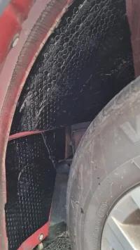

Next will be front arches with 2mm sound deadening and 5/10mm foam to the plastic cover. Going to add some deadening to the wings as well while the arch covers are off as they sound incredibly tinny. Certainly not worried about good coverage here but I seem to recall seeing somewhere that the wings are accessible when the arch liner is out.

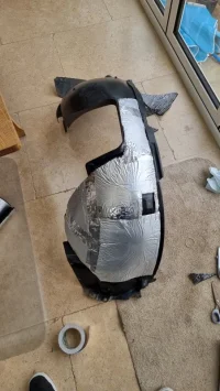

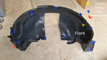

Front wheel arch liner has been removed - possible with the front wheels still on. I've marked it up with where the fixings are. Sound deadening added to the liner but I haven't finished the butyl yet. Hopefully these pictures reassure anyone thinking of doing it. Or if I've done anything stupid I'll find out!
8mm closed foam insulation and I've taped the joints with aluminium tape.

Possibly a silly question, would it not have been better to put the deadening and insulation (granted its not being used as insulation) to the metalwork rather than the plastic arch liner?
Surely this makes very little difference on the liners?

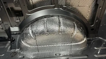

Only asking as I have LOADS of both the 2mm Dead'n and 10mm Aly lined Closed cell foam left over, will be doing the rear wheel arches (metalwork) from the outside in both as well.

So the sound deadening did go onto the metal but the foam went onto the liner. Mostly because that's what I'd heard being done elsewhere.
I think you get better coverage on the liner as it extends beyond where I'd be comfortable putting on the metal. Easier to apply while it's out of the van.
You might be right though and the metal would be better.
No idea if the wing makes a difference internally but on the knock test it's much better!

I did this for the arm removal
Worked well on the T6 although drivers side was a little tight.
As above front wheel arches were easy. Hardest part was the one plastic trim clip which broke but I had some spares.

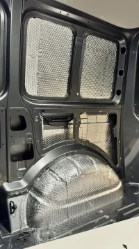

Sound deadening the doors and fitting the extra seals made a big difference. It's a bit sad but I smile every time the door thuds shut. The scuttle was a smaller differences and I imagine this will have less of an impact as well but they add up to a big difference. I don't regret doing any of them.
For the doors I loosened the inner door skin and got as much 2mm deadening as I could on the outer door panel, then coated the inner in as much as I thought was realistically going to make a difference then 20mm and 10mm foam on the door cards.
