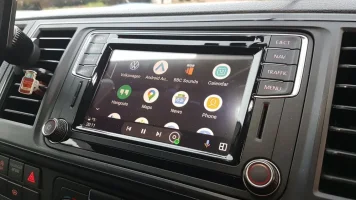

Activated / unlocked Android Auto (and voice commands too it would seem!) with a download from Vision Coding. With the new touch screen digitizer I fitted the other week, that's now our ICE sorted for now.

That's a good point, I should try to see if my phone will connect on a normal usbc rather than my "make it dumb" back to back adapters
Sad to report that the "make it dumb" approach is still needed.
Even better I now have the bottom "taskbar" area of Android Auto stop responding to touch (under conditions yet to be figured out) which requires a quick unplug/plug cycle on the phone. Not too bad but b**gers up music if streaming over the cable :mad:
But, yay, proper VW icon, yay... :unsure:
