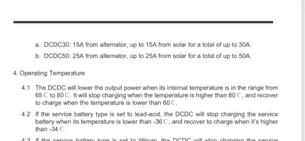

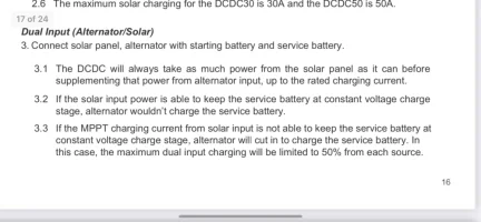

It’s actually a 30Amp Renogy, this one:
My usage isn’t the greatest, the biggest power user in my van is my fridge. Other than that it’s just lighting, USB charge sockets and my dashcam. For me 30A is plenty, if I had more load I’d probably go for the 50A version. One thing to be aware of is if solar is connected the power is limited to 15A (or 25A on the 50A version) from solar and 15A from the alternator.

Thanks for pointing that out. I swing between Victron individual units( pros are if one breaks then you don’t loose the lot - cons are space) and Renogy. I think you just swung
I went through the same decision process. In the end I decided on the single unit as I wasn’t sure I’d get multiple devices in the space i was using. I noticed yesterday that the Renogy was simultaneously trickle charging both leisure and starter batteries. I didn’t realise it did this so that is a bonus. I thought it would trickle charge the Starter once leisure was full but hadn’t realised it continued to charge the leisure at the same time. I’m going to try connecting the fridge up and leaving it for several days without using the van when i get a clear window to see how the solar performs with a constant load over a period of days. This will pretty well simulate how I’d use it in anger before I get out for my first proper trip.
