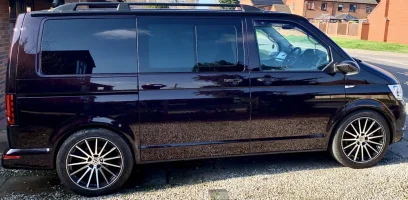

You're a man after my own heart. I sometimes feel a little bit of shame when I read about the car washing regimes of some others here on T6F (but not for long!).
I live in the country and if I do wash it in the winter its filthy within a week due to the farm traffic.
I believe it's better to leave it dirty so I'm not causing swirl marks by washing it every week in the winter trying to get the mud off.
I do use the 2 bucket method and it did take me a couple of hours to wash and dry but I find it quite therapeutic so do mind when the weather is fine.
