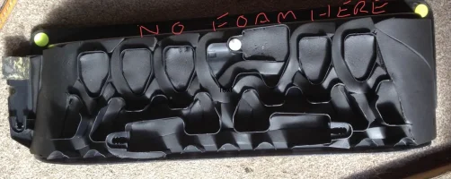

@Texxaco You can insert 10mm foam into the plastic step like this. Push down on the foam with the step to get an impression showing where to cut.
Other spaces are filled with strips from leftover foam.

@Texxaco I used Dynamat on the steel and 10mm foam on the step. I don’t remember needing to remove the door seal.
From memory the one place there is no space for foam is the vertical face, just Dynamat there.

I must be doing something wrong here. Dynamat on the vertical and floor only yet the step won’t sit ion, it’s proud hence I can’t get the door trim on.
Right door trim back on tomorrow and start again. Cheers for the heads up @DXX
