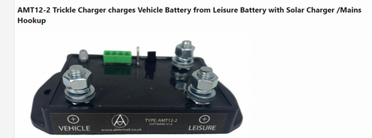

or try fitting a revers charger . . that will charge the starter from the leisure . .
or . . just add a second charger to the starter side thats fed from the EHU . .

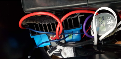

this is mine . . 12/12/30
so . . . yes.
The Orion may stay ON in the AUTO mode until the starter battery rest voltage drops to the switch off point. - it will the AUTO OFF.

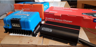

you could look at getting the IGN feed connected to it?
you could look at upgrading to the SMART version.?
