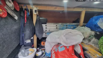

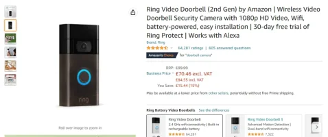

Current van CCTV is two ring cams, one in the front cab, and the second in the rear...
Ring cams....
And also the Blackvue dashcam is now 24/7.
as for the "CCTV" cams . . . .

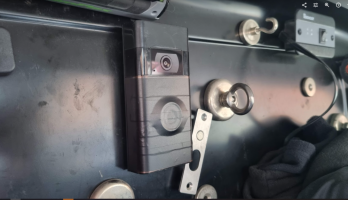

i have this one in the front - magnet to the bulkhead, though im sure it could be Velcro anywhere.
rechargeable via USB. - lasts a week or so.
and one of these in the back. . . . .
these cams take the Ring rechargeable battery pack,
you get one with each camera. . .
so i just bought a couple of additional batterys and a desk charger . . ( as i have about 5 of these stick up cams)
and the charger . . .
all of this is still running on the "HUAWEI Unlocked E8372h" USB travel router,
thats tucked above the roof lining, above the roof light switch panel. . .
with Three SIM card mentioned above. . .
super sweet cheap mobile WIFI, Internet, Security & Piece of mind.

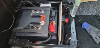

battery wise im running a Roamer 230ah Lifepo4. - Roamer - Premium LiFePO4 Leisure Batteries for off grid
so have ample power.
