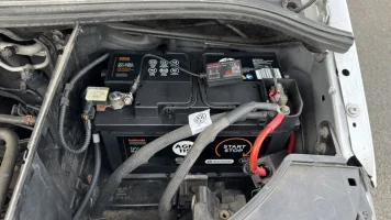

0428A33C-17E5-4C5B-9225-118BEA5514CD.webpBattery struggling in cold, also recent elec report suggested shagged. Will need to get halfrauds to replace and code as I have no access to OBD/ Carista etc. any ideas which battery I should go for that will fit T6, euro 5 engine? And that halfrauds sell? Have been told yuassa good
Not sure about those’d batteries at Halfords . But if you look at the spec of the battery above I fitted( use google) then if you make sure it’s agm and the nearest size to it (no larger )it will fit .

View attachment 270646Battery struggling in cold, also recent elec report suggested shagged. Will need to get halfrauds to replace and code as I have no access to OBD/ Carista etc. any ideas which battery I should go for that will fit T6, euro 5 engine? And that halfrauds sell? Have been told yuassa good
I went for their AGM 115. It’s slightly bigger (80ah) than the one you have but fits fine. The wrap around cover doesn’t fit but can be taped at the back if you are desperate to keep it on - I didn’t bother. The battery is made by Yuasa (with Halfords stickers) and has a 5 year warranty. Coding wise they need to change the capacity to 80ah and change the serial number by a digit. Depending on their coder they may be able to change to AGM too (Carista didn’t have that option for me).
If you know someone with a Halfords trade card it cost £142.
