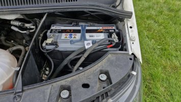

Fitted the larger Bosch AGM 95ah today. It's a squeeze but helped by taking out the sliding dividers. I replaced the jacket and stuff some foam at the back then wrapped it with shock cord.
Just an idea, I changed the battery serial number to YYYYMMDD00 so I know when it was last changed. I usually write that in marker on the top of the battery too. 1000018751.webp1000018750.webp

Well done, great battery! Took some forearm strength to get that one in!
