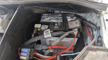

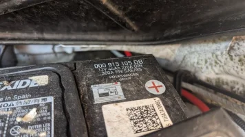

Just had a look at my LB (VW factory fitted under the passenger seat) and it's an AGM one. Could I then replace the SB with the same (AGM) so they would match then?IMG_20240711_100123528_HDR_AE.webp
So the ideal is to have identical batteries and same age - but if you change the starter and leave the leisure system as is I'd recommend you get that model of Varta AGM for your starter.
Are you certain the EFB starter is the original battery, I would have expected identical batteries to be fitted at the factory.
SB is Exide EFB (we had a campervan from brand new). Conversion started and then the 1st lockdown and all that. Unless, the original factory battery got drained and they (convertors) had to replace it and chose the cheapest one and fitted Exide one instead?
Sounds plausible and doesn't change any advice, was just a curiosity :thumbsup:
I was puzzled as well to be honest. So, on our return (fingers crossed) we should be looking for a Varta AGM one for a replacement.
