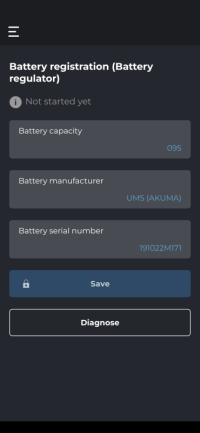

I'm in the same situation. I changed from EFB varta to AGM Yuasa and the garage said oh yeah yeah we coded it (when asked), but I checked on carista and it's still coming up with the old battery. Not only do I need the manufacturer code like you, I also need to change dual technology to AGM but that option just isn't thereI’ve upgraded to a larger capacity 019 Yuasa and tried searching for the answer but no joy…..
I’ve defined the new Ah and changed the serial (it was all ones before) but since I have no BEM manufactures code for Yuasa what should I use? OEM battery according to Carista was JCB.
@chazmanda from what I understand the main thing is to get the Ah set correctly and make sure the serial number is different. It seems a default serial number is 1111…. ( all ones). By changing the serial number tells ecu its a new/different battery and to recalculate everything. For me I just changed the last digit to zero.I'm in the same situation. I changed from EFB varta to AGM Yuasa and the garage said oh yeah yeah we coded it (when asked), but I checked on carista and it's still coming up with the old battery. Not only do I need the manufacturer code like you, I also need to change dual technology to AGM but that option just isn't there![]()
I think I read somewhere the Efb/AGM does make a difference and it should be set. Who knows for sure. I'll set the ah now and the serial as you suggest (thank you). Bit annoying as I when to garage because they could code it properly for me, I just got a yeah yeah everythings done response...hhhmmph.@chazmanda from what I understand the main thing is to get the Ah set correctly and make sure the serial number is different. It seems a default serial number is 1111…. ( all ones). By changing the serial number tells ecu its a new/different battery and to recalculate everything. For me I just changed the last digit to zero.
Re battery type take a look at CARISTA blog for details Battery registration —is it just snake oil?
Here's my before pic. I had a Varta before.@chazmanda was the manufacturer code in your image what you had before or what the garage recon should be the code used for Yuasa?
